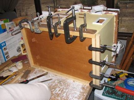

2. Start with the foundation. Turn the house upside down, or on its side, so you can examine the foundation. Check the glue joints, check the framing, see if there are any loose or “strange looking” crosspieces. I found a strange piece in Brimble’s foundation, and removed it. The whole house squared up and settled out, and was much sturdier and straight! I dug out lots of old glue and putty, scraped and sanded the edges, reglued everything, and added some reinforcement framing around the base of the outside walls. This made for a much sounder building when done.

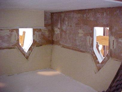

5. Priming is your friend. The Brimble was wallpapered on both the first and second floors. Here’s a major lesson I learned: if you’re thinking about redecorating a dollhouse in the future, and redecorating might include replacing wallpaper, prime the walls before installing the paper! The upstairs had been primed: the paper pulled off relatively easily, with only a few areas needing a wet sponge and soaking treatment. The downstairs was another matter: the walls had not been primed or sanded before the paper was installed. It literally took days of work to scrape off the paper, soak off the glue, scrape some more, then sand, to get the walls ready to prime and re-paper them. Good thing I still loved the Brimble!
6. Too much glue (and putty) is not a good thing. I encountered lots of both, in the “wrong” places, and applied in ways that disguised and in some cases damaged at least the appearance of the house. Careful chiseling with small artist chisels – the kind used for working in clay – worked well here to remove all the excess material from around the windows on the second floor, to restore them to their “church peaks”. Another few days labor, but well worth it in the end. Do go back though and re-glue (or putty) where necessary, filling in any gaps that are still showing.
